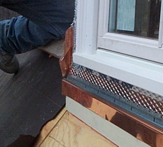

                         Counter flashing a slate roof
                            Here counter  flashing is put on this dormer
                            allowing the stucco to be finished.
                           A pre-painted one by six is put on, providing
                           a gap and a nailer for the step flashing when
                         the slate is put on. I have also seen just leaving
                          a large enough gap below the counter flashing.
                         The step flashing can then be nailed with a punch.

The solution is to counter flash the dormers and chimneys first
like above, finish the stucco on the dormers and chimneys,
put the slate on the roof, come back and stucco the main house later.
