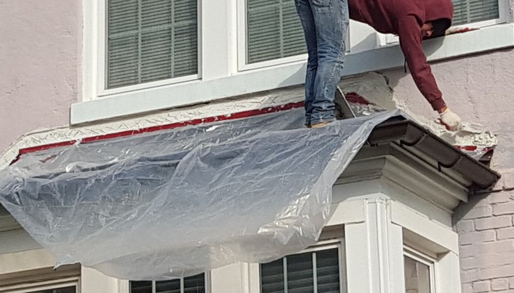

A window leak at the top can damage the stucco or the framing
under the window.
Water will run down the sides until it hits the framing under the
window. I have patched under windows on old houses for years, and
usually rusted out flashing, lack of flashing,
a rotted window sill is the cause of the damage.
Poorly installed window flashing.
Note how the top flashing was put on first and the side second,
allowing water to run down into the side flashing.
