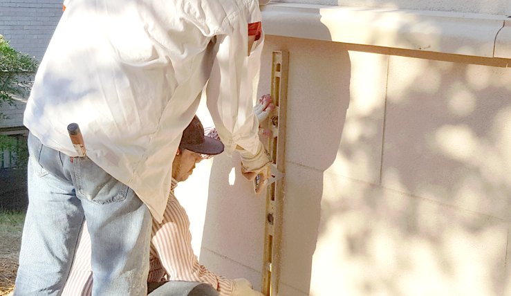

Joints are scored with a speed square on this new stucco house in Bethesda
Joints are scored with a speed square. Here, the square is held on edge to leave a rough, mortar like joint.
The square is held flat for a smooth joint in Bethesda, Maryland
The square is held flat for a smooth joint. Also the speed square marks off a dark line accenting the joint.
