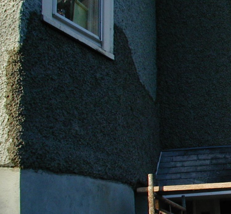

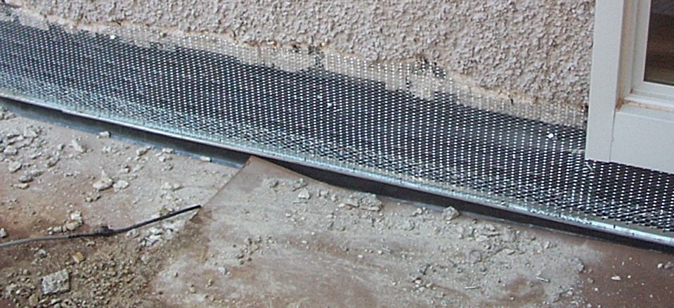

Crooked lines are better. You can see straight lines from window infills, etc. a mile away. Cutting back the edges of the patch leaving a crooked line also provides good overlap for metal lath:
Crooked lines help hide patches
This patch is a necessary evil for new roof flashing. The edge of the patch is left jagged and crooked.
Curving line makes this patch virtually invisible. Straight, horizontal lines are the worst.
