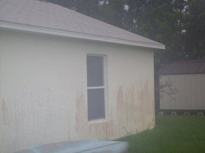

What is causing the stains on my house ?
Iron oxide, also known as rust.

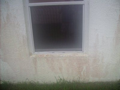

Stains on stucco
Also known as rust, in different forms.

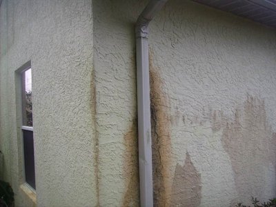

I have heard from readers that rusty lath is a huge problem in your state, Florida. The downspout here has been clogged up apparently for a long time. Water running out from the joint at the downspout and the elbow has deteriorated the stucco so bad that the lath has rusted through.
