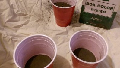

Adding more color to re-coat a new color coat.
Q-Rok for stucco finish

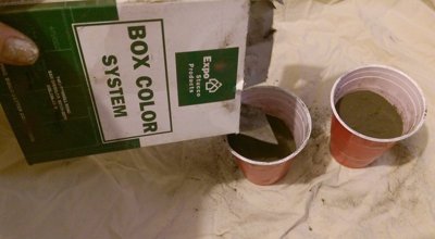

25% is easily measured using three cups. A color pack is measured by measuring two equal parts in 2 cups.
Measure that half in halves and you have 25%.
The reason for adding 25% more color is for recoating color stucco finish. If stucco is recoated with a color coat or colored white portland, the result is the color is lighter (whiter). The color can be adjusted by adding 25% more color. Expo stucco (now defunct) says 20% more color. To me 25% is easier to measure and we have had good results.
This may help in your situation.
What I would do: No chipping off. The wall can be recoated with a thin coat of your basecoat material using a chemical bonder 50-50 with water. Then, recoat the whole wall outside corner to outside corner the same day.
I wanted to share this 25% method. If you recoat a cement color coat with a new color coat, it will come out much lighter. The 25% method compensates for the lightness and your wall should look fine.
